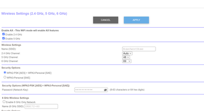

      Is Armor, SPC, IoT and Separate 6Ghz SSID networks enabled?
      - none of those items are enabled.  screenshot:
