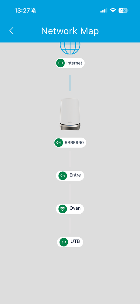

More strange things. There is no cable between “Ovan” and “UTB”. “UTB” is connected with cable directly to RBRE.
- EkkohDec 09, 2025Tutor
Didnt help with new firmware. Attached screen photo. Device "Entre" is connect with cable to RBRE but still uses WiFi. Even with poor backhaul status.
- FURRYe38Dec 09, 2025Guru - Experienced User
Might turn OFF the other two RBS and bring the one RBS to same room as the RBR and ethernet connect the RBR directly behind the RBR and see if the status will change to WIRED. IF it does, you will need to check into the cabling issue between the remote location where the RBS normally is placed and all cable lines in between there and the RBR.
Without having changed anything, the RBS has now connected to the RBR via cable. I’ll have to keep monitoring this.
