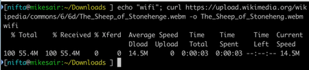

several replies seem to have disappeared, but someone suggested lowering the network speed when trying to download a large file over ethernet.. i have suspected it might be due to transfer going "too fast" (for the ONT?).. is there a way on the orbi router i can try throttling ethernet speed? or is this something that i need to do on the computer doing the downloading?
also, could MTU size be the problem? i have the orbi set to 1500, the ISP says 1500 or 1492 - i've tried 1492 in the past but wondering if there could be something wrong there.
