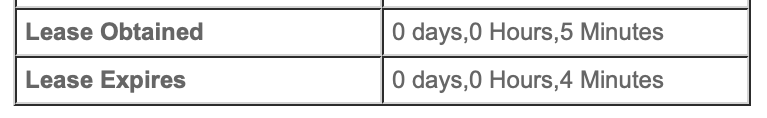

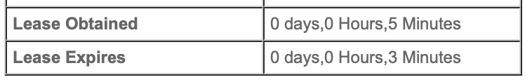

ahh interesting! thanks for that! it doesn't _seem_ to happen at specific times - sometimes during the night, sometimes during the morning.. tho it does seem have a habit of happening when i'm on a work zoom call 🙂 (but that may be a conscious bias on my part)
looking at the connection status, the lease obtained and lease expires values seem.. weird? i could be misunderstanding what they mean, but the lease obtained just stays on 5 mins, while the lease expires oscillates between 3 and 5 mins. is that... normal?
the next time it drops the connection, if i click release or renew then if the ipv4 lease is the problem, should it reconnect?
Legitimate value, certainly. Normal.... I think not. Providing a lease of 5 minutes (300 seconds) means that every customer device will renew the lease every 150 seconds. That will generate a huge amount of activity for their DHCP servers.
This part totally makes sense. Netgear is reporting the lease expiration in minutes. It starts at 5 minutes. After it hits 3 minutes (180 seconds), the lease should get renewed and the expiration time will go back to 5 minutes. 2 minutes and 1 minute will never be displayed because the lease renewed before the time got that short.
By my calculations, the Orbi router is renewing the IP lease 576 times every day. (as is every other customer router). Not surprising that it could fail now and again.
