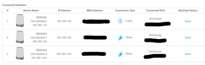

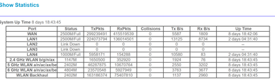

I have been having a problem lately with my RBR960.  The LAN ports just randomly drop.  I work from home and this is a problem when on video calls.  Could this be a firmware issue?  The router and sats are all running  V7.2.6.31.

    The router is connected to a 2.5GB switch for hardwired backhaul.  Off of that switch there are only two connections, for Satellite 1 and Satellite 3. My mistake was the LAN cable going to satellite 3 was connected to another switch in my office first before the Satellite 3.
    That switch was connected to my ARUBA for my work VPN connection, satellite 3, and other wired network devices (appleTV, rokuTV, onkyo receiver.)  In this configuration there were any spanning tree loops. I was treating the satellite as basically an AP.  What clued me in was a weird situation when it was in that configuration with a 4th satellite showing up on my topology with a broadcast address. Broadcast storm?!?!?!
    To correct this I simply connected the LAN cable from the 2.5GB switch (that is from the backhaul port on the router) directly to the satellite 3. Then used one of the 1GB ethernet ports off the back of the satellite to the 2.5GB switch in my office. I don't have any throughput issues.  On my VPN connection through my ARUBA I am getting much better upload and download speeds.

        What device is connected on LAN3?
        For LAN cable on from the RBRs 2.5Gb port to the MS305 switch, should be using CAT6A STP cabling. Same from the RBRs WAN port to the CM3000 Multi Gig port.
