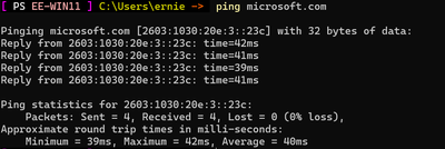

      EVERY system/computer that I have connected to the Orbi (wired, 2.4 GHz, 5 GHz,  6GHz - only) has obtained a DHCP address FROM the router AND has been able to access the internet.

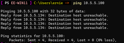

      What FAILS is machine to machine communications ON THE LOCAL network.  (This WAS working up until this weekend and it started failing.)  The simplest form of this is attempting to have two desktop computers (with ICMP enabled) trying to ping each other.

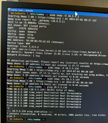

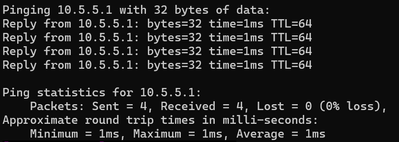

      If I ping the Orbi (10.5.5.1 ) it responds.
      If I ping ANY OTHER DEVICE on the network I get "Destination  host unreachable"

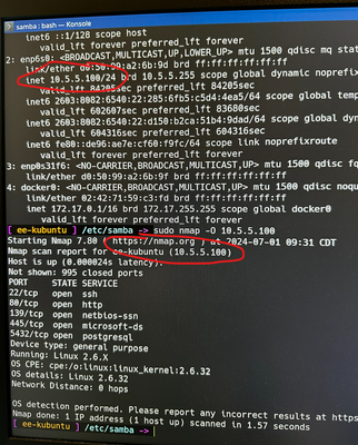

      In the case above it is a Desktop trying to ping a linux server
      The same happens when I try with the Desktop connected via a wire. (No screen shots)

      This shows the IP address (static via DHCP) given to the linux box and the local open ports:
      This shows some various tests from the linux box:
