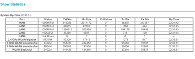

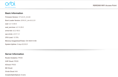

    Can you post the debug data seen there along with the Show Stats page from the RBR?
    Take a screen capture please.
    Router IP address/debug.htm

    • z7's avatar
      z7
      Please see the debug and connection statistics below.
