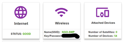

Just as I was about to try a reboot test tonight to see what is going on with IPV6 and the lost Sat, the Orbi decided to disconnect / reconnect itself and lose the Satellite.
I did a pin reset on the Satellite. That seems to do nothing obvious, but didn't know what else to try - maybe it helped - hard to say because of so many strange buggy behaviors like this:
But, in fact, the Satellite is back up as shown here:
The Browser Page shows devices connected to the Satellite, the Orbi App says nothing is connected to it - and the App is correct as the IP addresses shown on the Browser page cannot be pinged. That and the Satellite is in "zombie mode" again - nothing that connects to it can see the network. I had to power cycle it again to get it to come back up and be a part of the network. And now it shows up correctly on the Main Basic Browser page as attached. When it is in zombie mode, I can ping it, and see it as connected, but it is only "half" up and anything that connects to it doesn't see the network.
So far, I cannot say this older firmware has been any better, just different issues and plenty of them.
