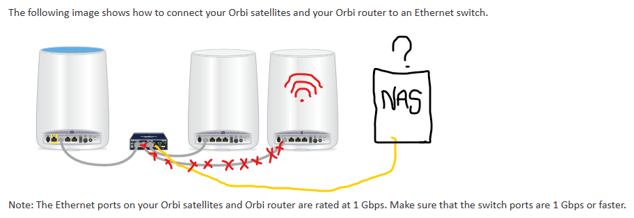

The main is connected to a pfsense firewall and at one point (before wanting to add the basement satellite) it was configured in AP mode with the firewall router providing the dhcp server, etc. After adding the basement satellite, I wanted to reconnect the NAS to the network and make use of it's 2.5gbe connection for backups, etc. so I installed a 2.5gbe unmanaged switch and connected the basement satellite and the nas to it. (see pic)

I then plugged back in the ethernet switch with the basement satellite and nas and after using the sync button, the wired satellite reconnected, but I don't see the nas unit. It's not listed in the attached devices in the orbi web page or app. Arp -a from my desktop connected via wifi doesn't show it, but it shows many of the other devices including some of the stuff connected to the IoT network, but not the smart outlets (which only show up after being pinged directly and have a 60-250+ms response time). A ping to the old ip of the NAS returns undeliverable as my guess is that the orbi is sending that request out it's internet connection and then the reply is returned from it's external address that is the next higher ip address in that subnet (in 10.0.0.0/8).
I haven't received any training or education in networking so there might be some tool to try and discover if it's still there, etc. but at this point I don't see it. So before going through running more network cables through the house, I'd like to know if the Orbi will even connect to it if it's basically using the same port as a satellite? Or does the orbi do something internal like configure that network port to only accept satellite connections with the backhaul set up and block/ignores any traffic without it?

  • Yes, other devices can connect to the LAN switch thats in between the RBR and RBS.
    What's the brand and model# of this LAN switch?
    Be sure to use good quality LAN cable as well. CAT6A STP for 2.5Gb or higher connections.
  • Reconfigure the NAS to use either DHCP, a DHCP reservation (fixed IP), or at least to an IP address in the same subnet like your RBRE960B 192.168.1.0/24.
    Most easy way would be to temporarily configure a PC or a MAC to the 10.x.x.x/?? address on the exact same subnet address config like your NAS.
    There is not much sense in configuring a bigger IP subnet, because the system does only support 256 (254 useable) addresses.
