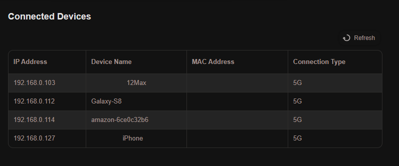

I notice that no wireless devices are currently register to the RBS50 for some reason?
I read I can use the older satellite on the RBR850 so not sure what the issue might be. I do have a laptop cat5 wired to the switch of the RBS50 so I know the RBS50 is working, at least wired
Any thoughts?

      Does the RBS-50 show up in the Attached Devices list as a Satellite?  If so, what does it show as backhaul status?
      • ssgtweasel's avatar
        ssgtweasel
        Guide
        Yes it does
        It shows WIRED and GOOD
        no devices are connected via Wi-Fi
        2.4 and 5ghz is enabled
  • A laptop with cat6 is connected to the RBS50 that is connected to my core 1gb switch
    So the data switch portion of the RBS50 is working
    No devices are connected wireless to the RBS50
