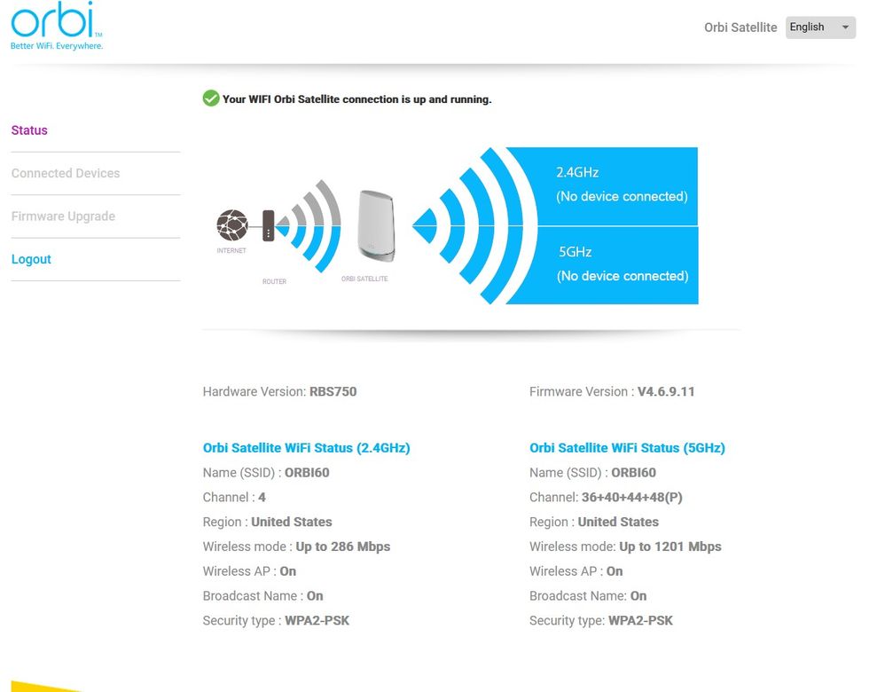

Hello, my satellite doesn't act as a satellite/extender anymore. No devices can connect to it wireless but the ethernet ports work just fine. I've tried resetting both the router (CBR750) and the satellite (RBS750) back to factory mode and still have the same issue. Does anyone else have this issue? I've updated to the latest firmware V4.6.9.11 and I wonder if I can get it replaced?
You need to downgrade the RBS FW to what is posted here for the CBK7 series system:
https://www.netgear.com/support/product/cbk752.aspx#download
Do not use RBK7 series FW for RBS that come with the CBR750!

OMFG that fixed it. Thank you sir. I was so confused and spent hours researching.
