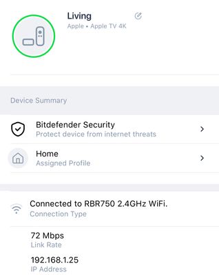

RBS750 will only allow Apple TV connect using 2.4GHz Wifi
My RBS750 is hardwired from the RBR750 with gigabyte internet. It is about 5 feet from this Apple TV. It's been working fine until yesterday until I experience buffering while streaming videos. After looking in my "Attached Device" on the app, I notice it refuses to connect using 5GHz after many attempts to reset my routers, forget network and reconnect, and hard reset on the Apple TV itself.
There are other devices that's connected to this router with 5GHz. I'm sure why it's using 2.4Ghz with a 72Mbps link rate when the router is so close to it. Could it be the Apple TV that's malfunctioning? I have another Apple TV that connect to my RBR750 in 5GHz all the time.
Any advice would be great!

  • Apple devices are good is choosing the best wifi AP to connect to. To make sure that your Apple TV is not faulty, can you swap your 2 Apple TV’s locations and see if the fault will move with the device or not?
    It’s definitely the device who decides which band to connect to. Also Orbi has band steering which will always try to push the devices to the 5GHz band if the devices report to be able to support that.

    Why not ethernet connect the ATV to the RBR or RBS?
    What channels are you using? Auto? Try Auto and 48 on 5Ghz. Or try setting manual channel 1, 6 or 11 on 2.4Ghz and 40 to 48 channel on 5Ghz.
    Any Wifi Neighbors near by? If so, how many?
    It's up to devices to pick and choose what frequency and signal source they connect too. Also try turning down the power output of the RBRs wifi radios from 100% to 50% and see if this changes anything. Under Advanced Tab/Advanced Settings/Wireless Settings
