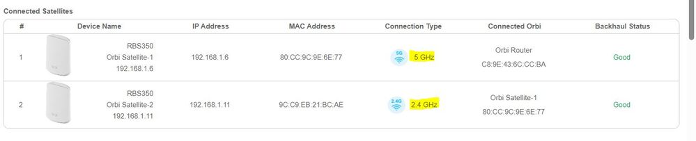

- Rob6805TutorThe RBS350's constantly go out of sync with the RBR750 router. If I pull up the settings application I can see the sync status toggle back and forth. It's done this from day one. I have a wifi camera that is closest to one of the satellites but it will not connect and use the satellite. It connects to the router and thus has a poorer connection.
- Rob6805Tutor
I just updated the RBS350 satellites to the same FW ver that the RBR750 router has. I now see the backhaul status as Good for both where before they would toggle out of sync. The one that is furthest away is using 2.4GHz which I assume is to be expected. Thank you both for the help!!
Good to hear. Glad you got it working. Please keep in mind about the FW versions between the 350 and 750. You'll need to keep this at the same level for the 650 series kit. v7 FW is not compatible.
Farther distances will connect to 2.4Ghz.
Be sure to save off a back up configuration to file for safe keeping. Saves time if a reset is needed.
https://kb.netgear.com/000062080/How-do-I-back-up-the-configuration-settings-on-my-Orbi-WiFi-System
Enjoy. 📡
