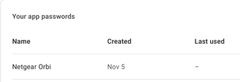

I tried changing 587 to 465. I also generated a new app-specific password to use with my email address.
Then I clicked on "Send log" about 4 times. I have no email of the log (not in spam either), and there is no message in the log - it's been 30 minutes now.

      Hi TC_in_Montana , thanks - I Had 587 originally, I'll go back to it. I do have an App password, which Google says is for apps that can't handle 2FA:
      The link you sent was a little different for Outlook than what I am doing as far as I can tell, but I should have it correct.
