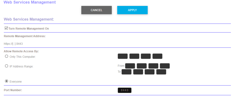

Can you attach a screen shot picture of the Remote Managment page please?
So you see a chack box here at all to turn ON or OFF?

FURRYe38 wrote:Can you attach a screen shot picture of the Remote Managment page please?
That is what is so not-funny: there is absolutely NO PAGE even close to controlling remote management on the CBR750.What is the full path to your web management page? e.g., Advanced tab: Setup or Administration or Advanced??
Show me a screen cap of Advanced tab/Advanced on your CBR...
Thats where RM should be is under that path...
- energieLuminary
The page might exist, however the menu item might be missing. Have you tried using a direct URL?
- http://orbilogin.com/FW_remote.htm
- http://192.168.1.1/FW_remote.htm

energie wrote:The page might exist, however the menu item might be missing. Have you tried using a direct URL?
Nope - but great idea to try.
