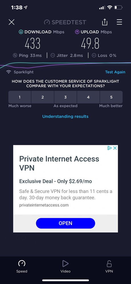

        Turn OFF the RBS and connect the iphone to the RBR. Speed test with Ooklas installable speed test app on the phone.
        Also I mis-spoke about iphone speeds, They will max agout at around 400-500Mpbs, not 600-700. This is due to the antenna configuration on the iphones. 2x2. IF they supported 4x4, then the speeds would be higher.
        Here is a test with my Iphone 12 Max and RBR 850:
