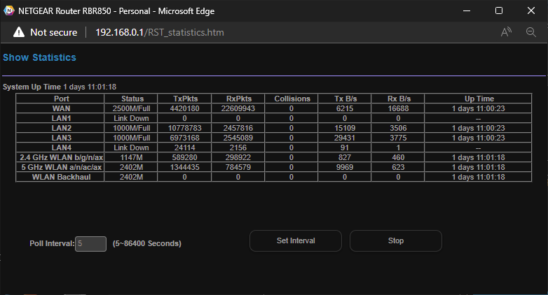

        What is the connection rate seen on the PC with the CM modem? 1000?
        When you connect the RBR to the CM2000, what connection rates do you see on the RBRs statistics page?
        You should see 2500Mpbs:
        You should see same as what I see with mine on the WAN port and the multigig LED on the modem should be BLUE:
