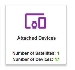

Status/Firmware Upd shows 1 Satellite - but there are 2 connected
I have a RBK853 system (two satellites). One is wired, one is wireless.

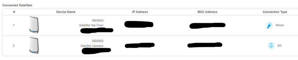

On the main page it says I have one satellite (the wireless one) and when I try and check for new FW it only shows one, but on the devices page I can see both satellites. How do I get the main router to properly recognise the other (wired) satellite?
Using V4.6.3.16_2.0.51 and the router is in AP mode.

      This only happens when it's wired.
      If I disconnect the hard wire and connect it wirelessly, then there's no problem at all and it shows two devices.
      • Is the wired RBS directly connected to the back of the RBR or is there a LAN swtich in between the RBR and RBS?
