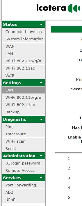

      Regarding #2. Can't seem to find anywhere to do this:
      "configure the modems DMZ/ExposedHost or IP Pass-Through for the IP address the Orbi router gets from the modem."
      These are the options I have.

        Ask the ISP about the DMZ or IP pass thru. Hopefully it has one of those features.
        Might give AP mode a try with the ISP rouoter and see if speeds are better...
