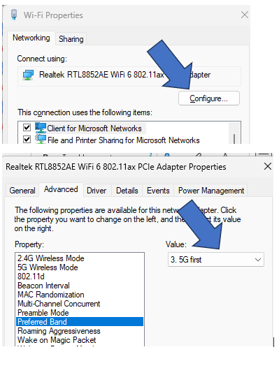

    Perhaps it would be worth checking the settings on the WiFi adapter.  From the Windows Control Panel, select Network and Sharing Center, then Change Network Adapter Settings.  Right click on the WiFi adapter and select Properties.
    In particular, look at the configuration settings for Preferred Mode. (My old adapter does not support WiFi6E, so your adapter may have different settings.
    One would hope that this Intel 211 adapter would prefer 6G first.
