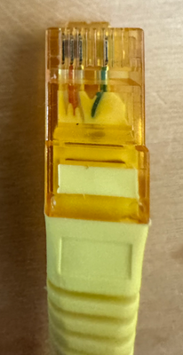

  • Had the same issue. The problem was the CAT5 cable didn't have all of the pins connected end to end, shown below. Replaced with a cable with all wires connected and it came up 1000M
    • FURRYe38's avatar
      That would certainly be a cause. Why we recommend CAT6A STP for 8 and 9 series Orbi systems.
