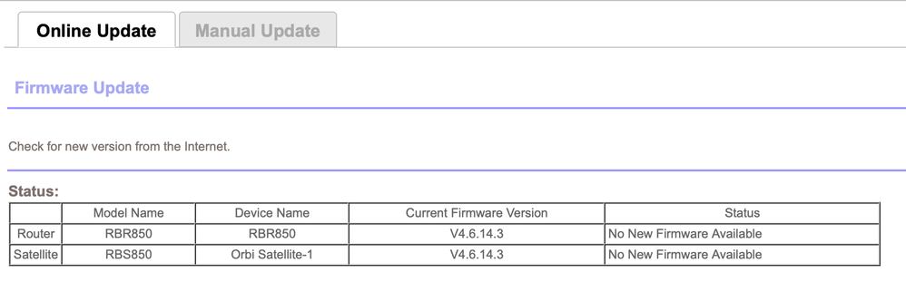

Your behind on FW:
- sh0Aspirant
Thanks! Of course the admin UI shows that they are on the latest. I'll start there.
