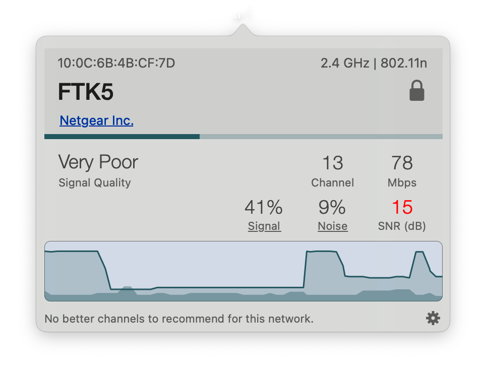

WiFi drops connection 5-15 times a day and it’s for 30 seconds - 5 minutes at a time
Hello all, I have a RBR850 — Orbi WiFi 6 Router AX6000 with 2 Satellites. All was working fine and since 2/3 months I have my WiFi droping connection 5-15 times a day and it’s for 30seconds ...

So I did the factory reset (thru the GUI) and re setup everything from scratch.
Sadly this didn't do a thing, wifi keeps dropping randomly and every so often :(
I removed one of the RBS and the same happened. What I'll do next is swap the RBS to see if the problem is still there.
Beeing full remote this situation is really draining my patience and fully impacting my work.
It seems the macs are Roaming for whatever reason between stations and bands.

What channels are you using? Auto for 2.4Ghz and 40 for 5Ghz
Any Wifi Neighbors near by? If so, how many? a Lot, really a lot, welcome to Paris, but this has always been the case.Thx.
