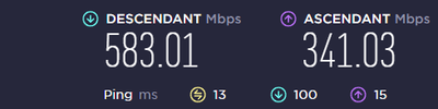

Hello , I have put 3 AX6000 on my network.
My service provider 1Gb, Speed test on LAN : 125Mb. on WIFI 19MB!
However, the satellites are connected to 1Gbs switches which are also connected to 1Gbs LAN.
On each switch where the satellites are connected, in LAN I have 120Mb in Wifi less than 20Mb.
I have try to reset factory, same pb: slow wifi connection, In 2.4 an 5GHz. My house is not big (under 100m²) And only 3 houses around me.
How can I do to increase the speed of the wifi?
Thanks.
C.

    The 1 Gb to 125 makes me curious if you test on the LAN in Gb/Mb (bits like carriers do) or MB as computers count data transfers.
    Similar, for these 19 or 20 on WiFi - Mb/s or MB/s? Testing on your LAN or to the Internet?
    Last but not least, what mobile WiFi clients are used? This is where o e would expect the big differences coming in after streamlining the units on a good set-up like yours.
