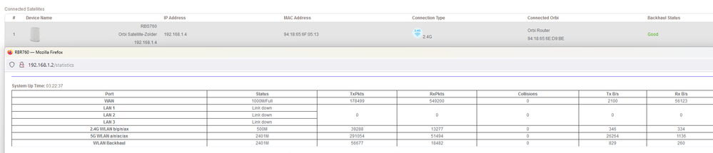

Yesterday I clicked the 'statistics' button in the web interface and saw this:
The interface states the the satellite has a 5Ghz connection, but the WLAN backhaul status indicates 500M, which is clearly not the 2400Mbps the 5Ghz connection should have.

    Thanks for attaching the screen shot.  This appears to indicate that even though the physical distance between router and satellite is only 5 meters, the WiFi link is  operating at 573Mbps (i.e. horribly show)
    The most common reason for this would be building material between the two units, such a concrete floor.
    It might be worth confirming that the satellite "works" by temporarily relocating it to the same room as the router. (Good thing Orbi satellites are portable!)  If the satellite is placed in the same room and powered up, the WiFi backhaul link should be very close to the published rate. (2400Mbps).

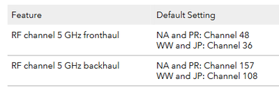

    Netgear does not appear to have included Factory Settings in the 760 User Manual (sigh), but the settings for the 750 product are:
    In many parts of the world,  WiFi channel 108 is in the frequencies called DFS/TCP  (see footnotes)

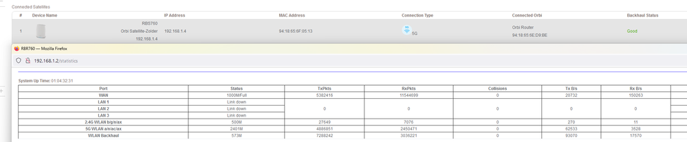

      Apologies, somehow my last post was not posted.
      I did as you said, and got the following:
      Whenever the attached devices show a 5ghz connection, the backhaul drops to 2.4ghz.
      As for building materials: Satellite is placed directly above the router, so it only has to pass wooden floors. And no known military or weather stations nearby.
      • CrimpOn's avatar
        CrimpOn
        Thanks for posting the screen shot.  This shows the WLAN Backhaul as 2401M. This means 2,401 megabits, i.e. 2.401 gigabits.  This is the maximum 5GHz backhaul.
