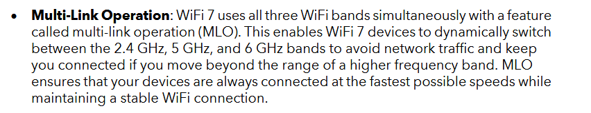

    It would not surprise me if there might be a disconnect between the folks who write User Manuals and the software engineers who create the actual firmware.

      Though maybe in user manual the over all MLO uses all 3 frequencies for MLO, actual use in NG Orbi systems is ONLY 5 and 6Ghz to be specific. 2.4Ghz is NOT used for MLO in Orbi BE systems. Ohter Mfrs may or may not follow what NG is implementing nor follow what specs for MLO support.
      There are known issues with MLO at the chipset and wifi, and Mfr level, both router and Apple and Android level. So until they can get it all figured out, we'll have to deal with the issues at hand and use donawalt​ s work around that may help some with newer generation wifi devices, ie Apple or Android.
      It's recommended to leave the 240Mhz check box uncheck and disabled so the system will auto adjust the BH and should use 6Ghz at 320Mhz if the conditions are good for this connection rate.

    CrimpOn​ that's odd, the WiFi 7 Orbis do not use 2.4 GHz in their MLO from what I have seen - I have an iPhone 16 Pro which will report using 5GHz+6GHz on the router and in device list page. Apple device sat least have no way to turn off MLO permanently; while there is a "WiFi 6E" setting that can be set to Automatic or Off, even if it's off MLO is preferred by the vice so it will turn it back on! I wish it could be disabled on the router - it has issues right now in the Orbi world, at least on the 970s (disconnects/flips to cellular when there is a strong WiFi signal nearby).

    Confusion is appropriate.
    While the OP referenced finding an option in the web interface: "advance wireless settings (MLO Backhaul)", The 970 User Manual describes MLO in more general terms:
    In this sense, a WiFi device can take advantage of MLO only if it is a WiFi7 device capable of MLO.  Not having a 970, I have no idea whether there are separate settings to enable MLO (a) for user devices, and (b) for the Backhaul link.
    There have been posts on the Forum remarking that MLO does not appear to function on some of the Netgear WiFi7 routers and asking when it will be released.
