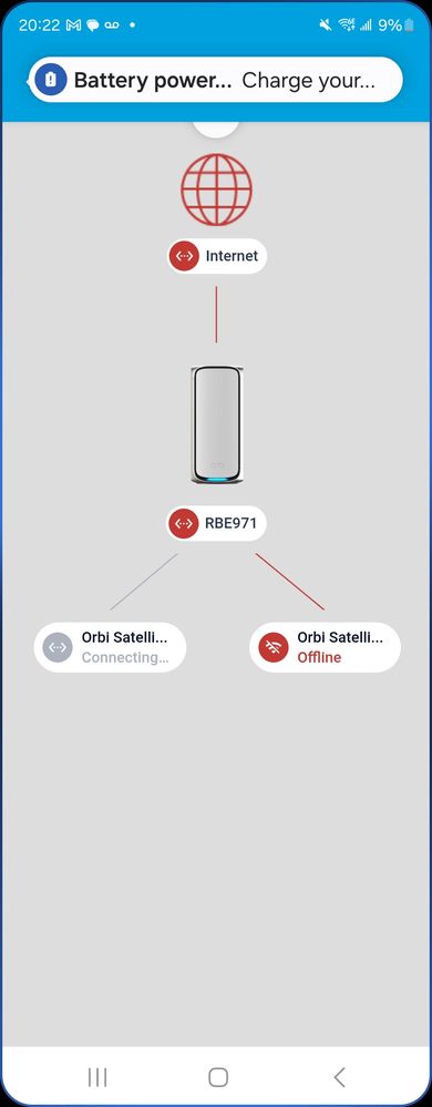

Like every story before, things were working perfectly until an ethernet adapter failed on me.  That forced me to reinitialize the Orbi (which was in AP mode).  Since then, every time I factory reset it and then changed to AP mode it does the same thing
Upon reinitialization - and then placing into AP mode (again), the orbi app shows RED - No internet.   I have factory reset and reinitialized more times than I wish to count in last 24 hours.
The odd thing is that WIFI appears to be working... somewhat.

      Yes, I have rebooted several times after converting over.   Before converting, it works perfectly as expected.  Once in AP mode the wheel falls off and it reports red on the ap... but I am thinking the devices and wifi may be actually working so I am not sure if it an app problem or a wifi issue.
