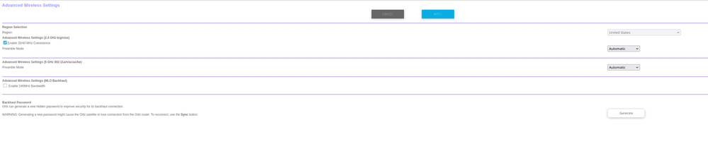

Yes I have setup the router from scratch after loading the latest firmware. I only have the 970 providing wifi for all my devices and usually I am seated in front of the router (line of sight) when these disconnects are happening. I am running Android 16

Does this happen with the RBS turned off?
What channels are you using on the RBR?

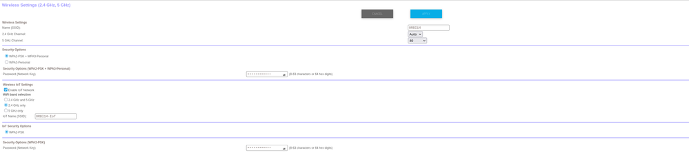

Also someone reported changing the WPA settings to WPA3 only on the main WLAN and setting up IoT network for those devices that don't support WPA3. User saw good connections with there new gen Apple devices. Wondering if you could give this a try as well?

Confused with the question "Does this happen with the RBS turned off? " there are no satellites in this setup just the router only. Guest network is disabled as well
I havent changed these settings since the factory reset
