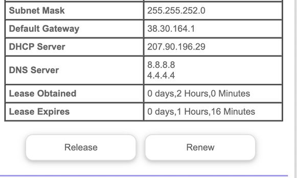

Something to please try when you notice the RBR has lost internet connection or services. Please log into the RBRs web page and do the following, on the Advanced tab/ Internet section. Select Release / Renew from the Web GUI / Connection Status window and see if restores the internet connection. Please let us know the findings of this.

I think you mean Advanced, Internet Port, Connection status. By the time I get to this the connection has already restored.
