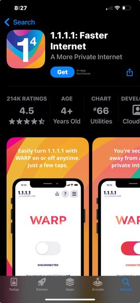

- FURRYe38Jul 11, 2025Guru - Experienced User
Is this the correct app?

The app is also available in the Apple store. So with VPN in the device activated you are essentially bypassing IPv6 settings in the router and using IPv6 from Cloudflare. This can work if you need IPv6 until NG resolves the IPv6 problem.
