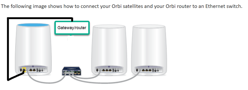

You said you had the switch connected behind the gateway router...Move the switch connection to behind the RBR:
Gateway router LAN port connected to Yellow WAN port on RBR<>RBR in AP Mode>Switch connected to a open LAN port on the RBR<>RBS connected to switch.
What brand and model# is this switch?

Move the switch behind the RBR or connect the RBS directly to the back of the RBR while in AP mode. RBS require being connected behind the RBR, either in router or AP mode to sync correctly.
https://kb.netgear.com/000051205/What-is-Ethernet-backhaul-and-how-do-I-set-it-up-on-my-Orbi-WiFi-System 📡 ‌‌🛰️

I think that is how I am set up. If not, tell me what to move?
