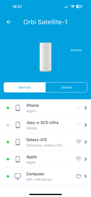

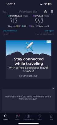

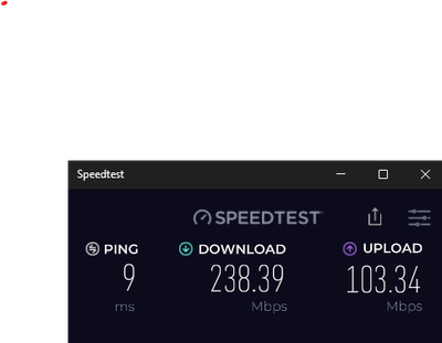

Experiencing issues with wired connections to my 770 satellite. I've got the satellite connected on wireless backhaul to the main router about 15ft away. I've run tests both on my IPhone 16 Pro connected via Wifi 7 and computer connected via the 2.5 Gbps port. My Iphone is getting 700Mbps speeds whilst my PC is slower at 250 Mbps, surely I should be getting faster speeds on my PC which is connected through Ethernet? I have verified through the app that both devices are connected to the same satellite (I've only got 1 at the moment)

    What chipset WiFi adapter brand and model# is installed in the PC?
    Be sure drivers for this adapter is up to date.

    Does this happen with the RBS turned OFF?
    Just one RBS deployed?

       If this is a recent purchase, it might be a good idea to contact Netgear support before the 90 days of 'complimentary support' expires.  Your observation that 250Mbps speed for a wired connection is "not right" is correct.  When contacting support, it will be very helpful to know the details about the PC and the Ethernet card that is in it.  I have seen reports on the internet of "issues" between 2.5G capable Ethernet ports and conventional 1G Ethernet ports.
