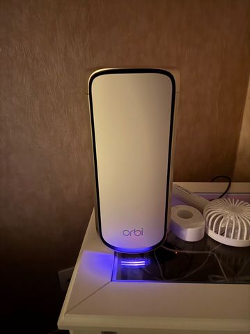

Saner
Jun 10, 2025Apprentice
Below some pictures that I took when 971 crashed during the Speedtest via Orbi App.
It shows 6Gbits and few seconds later it loose the connection with main modem (magenta light). Only a restart will help.
I was using the fan on the top of the router to test the difference with and without fan.
With fan usually 971 was able to run 10+ consecutive Speedtests.
Jun 10, 2025Guru - Experienced User
And what mode is the RBR in currently? Router or AP mode?
Sounds like this maybe isolated to your unit. Something NG support will need to handle. RMA hopefully will resolve. Won't be much else to try until the RMA unit arrives.
Only other thing to try in mean time, if you have a family member or friend that has same or different ISP service, take the RBR to there place and test it there. See if problem follows or not.
