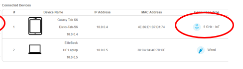

      Thanks, I got it connected. But how do I tell what is connected to what network?
      • CrimpOn's avatar
        CrimpOn
        The Orbi Attached Devices screen displays this information in the Connection Type field.
        For example, a Samsung tablet was connected to the IoT network of an RBR750:
        Notice the Connection Type is 5GHz - IoT
