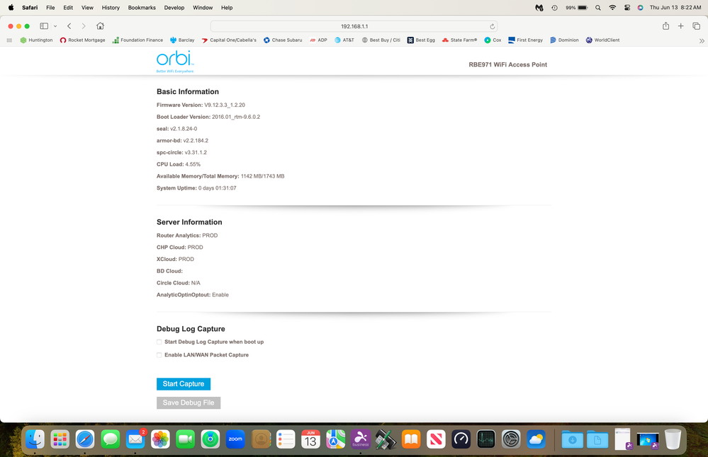

    Please post a screen capture of the routers debug page. router IP address/debug.htm

      Software = v9.12.3.3
      Arris S33 Modem
      Cox Internet
      Cable Cat6A
      Ipv6 Enabled = yes
