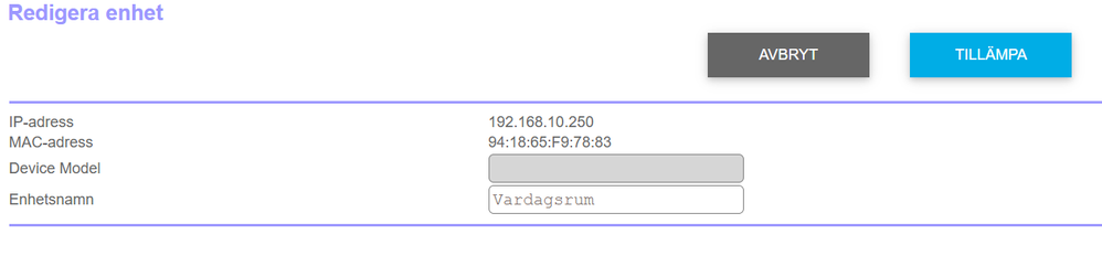

  • When I select "Edit Device", this screen appears.
    There is no "Remove" button anywhere.
