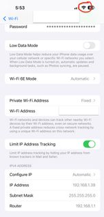

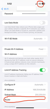

Overnight my iPhone 16 Pro Max was on the night stand. Strong WiFi connection. This morning, I pick it up off its wireless charger stand, walk about 8 feet, sit down to start checking the morning emails. In about 1 minute it went from strong WiFi connection to 5G cellular, even though settings still showed it connected to my WiFi. Router IP was blank, no IP address:
 I waited about minute doing nothing then WiFi came back:
