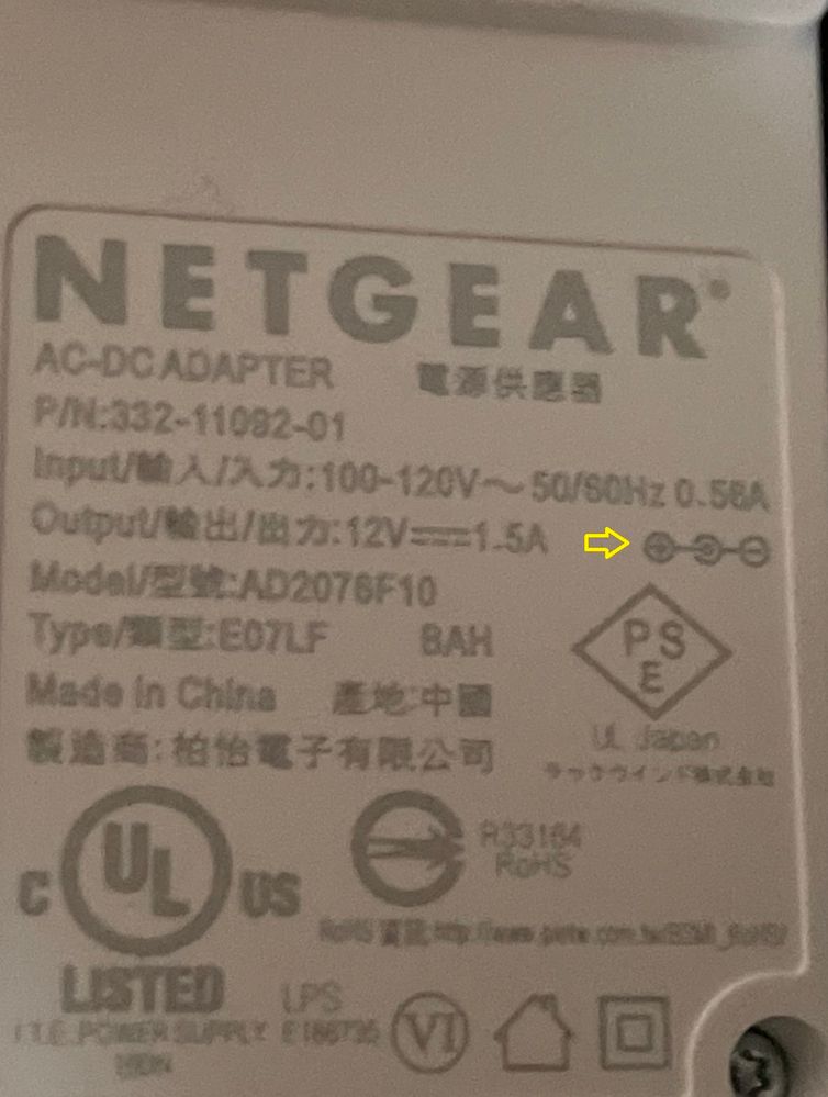

    • StephenB's avatar
      StephenB
      Note the old adapter will have a label with the Netgear part number printed on it.  Googling that might help find a compatible replacement.
      You are looking for an adapter with a 12 volt output and at least 1.5 amps (18 watts).   Double-check the amps on the label.  More is ok, less is not.
      Most Netgear adapters are center-positive (not sure if all are).  There is an icon on the adapter label that will tell you this for sure.  This has a partial outer circle with a dot in the center, with one circle on each side.  One side circle has a +, the other has a -.  The center dot will be connected to one of the side circles - that tells you whether the center is positive or negative.  Here's a photo of one of my adapters (for an Orbi 870, so might not match yours).  Low contrast, but you can see that the center dot is linked to the + sign,
