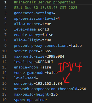

My steps for port forwarding are as usual, download all necessary files and edit some adjustments which are labeled here in the server.properties file using my local IPV4 address:

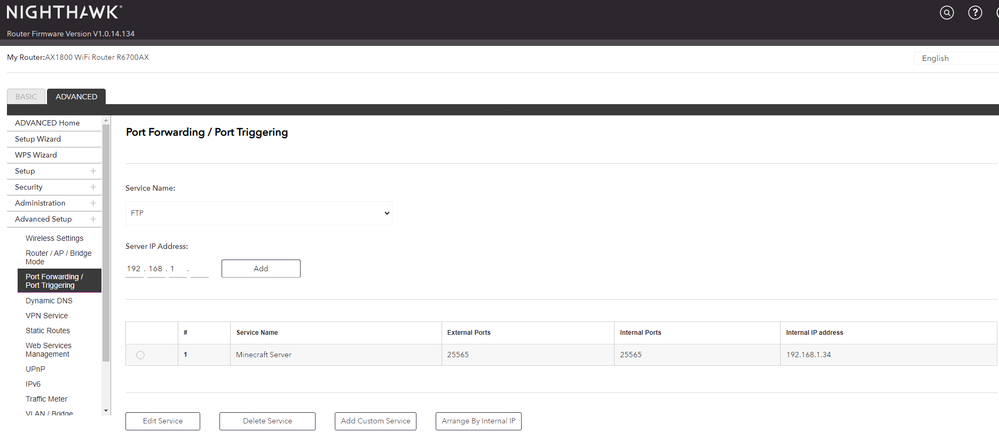

Then I enter my model using my username and password, locate the advanced tab, drop down the advanced setup menu and clicked the to Port Forwarding/Port Triggering section to input a custom service:
When making the custom service, I enabled the TCP/UDP protocol, set the external port range to 25565 and checked the box to use the same port as an internal port, and set the internal IP address and the one on my device being 192.168.1.34

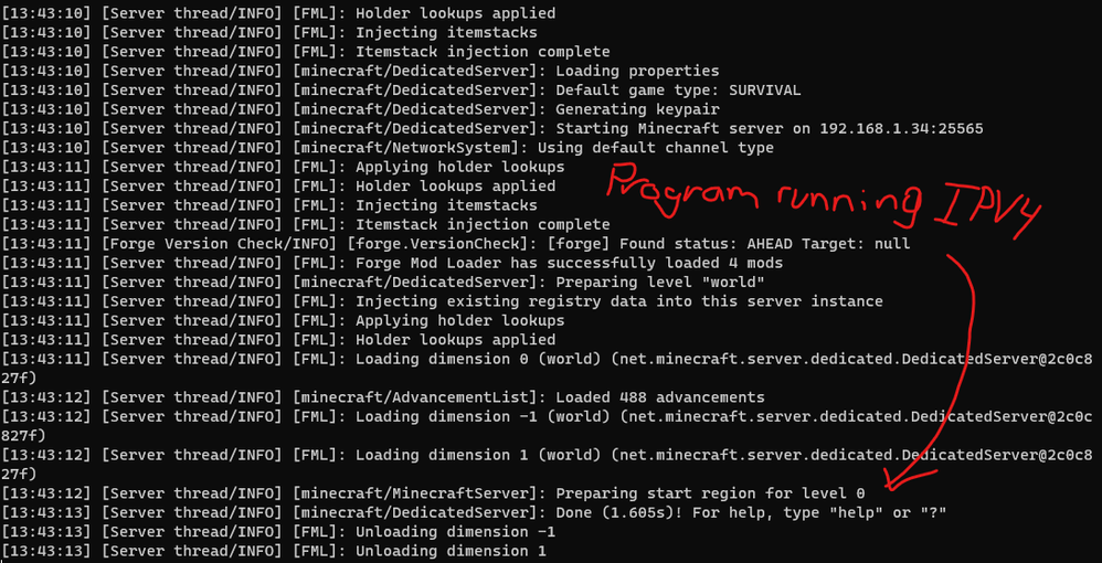

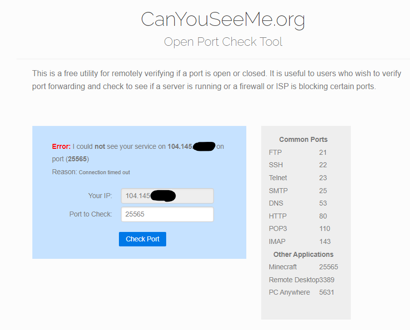

While running the program via the command prompt as shown below using the server.properties settings shown above, I checked if the port was visible via my public IP address which will also be shown below.
Double checking via Minecraft, I could see the server was not running via the public IP, but was running using my IPV4 address, however, that means no one else could join but me, meaning I definitely messed something up while Port Forwarding.

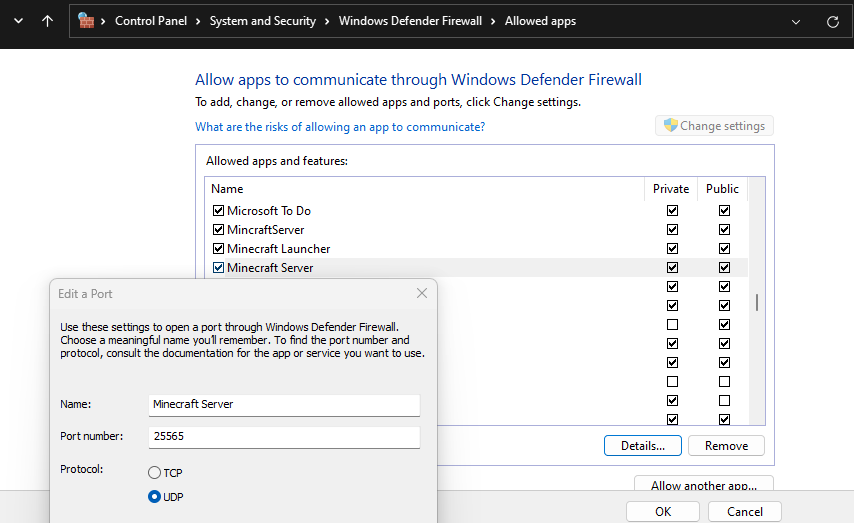

Per many suggestions, I enabled exceptions to the port 25565 (Minecraft default port) to both TCP and UDP inbound and outbound as well as allowed an app through firewall for TCP and UDP to no avail.

  • schumaku's avatar
    schumaku
    Check your R6700AX -> Internet Connection and compare the IP address shown there is the same you have in this checker with 104.145.x.x? If not, your Internet connection is some carrier grade NAT connection, and not connectable over the IPv4 IP address.
    EDIT: 104.145.x.x does not look like a CGN network address, which is typically in the 100.64.0.0 - 100.127.255.255 range. So the problem is elsewhere...
