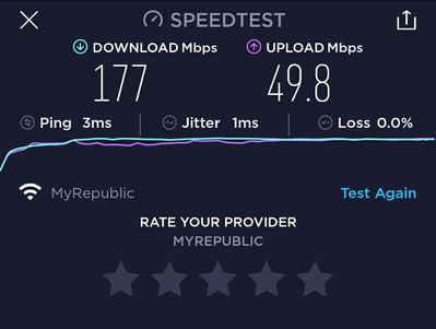

Hi experts,
I am not sure why the testing results are so different. The same mobile, router (RAX20), ISP.
Any thoughts?
Thanks.

    I am not surprised at the speed between RAX20 and the internet, but my testing device (Samsung S20 FE even supports wifi 6), can only up to 177...
    Before I used the older generation of Google Wifi (not the newer model, Nest) it can run to almost 700...
    Feel unacceptable that I bought a new router but my wifi speed downgraded from 6xx to 177...
    Thanks.

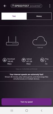

      How are you doing these tests?
      Speed tests carried out on the device use the wired connection, even when you are using a wifi client to tell the router to run the test. These are inevitably faster than anything done with wifi.
        Thanks.

      When you test off the nighthawk app, it hosts the test directly off the router. Its not always accurate as the built in speedtest on that one doesn't always choose the best server. But is going to be faster than wireless as its basically testing a hardwired connection.
      When you run it off your phone/pc it depends on how its connected to the router. wireless is going to be slower than wired and 2.4ghz is much much slower than 5ghz.
