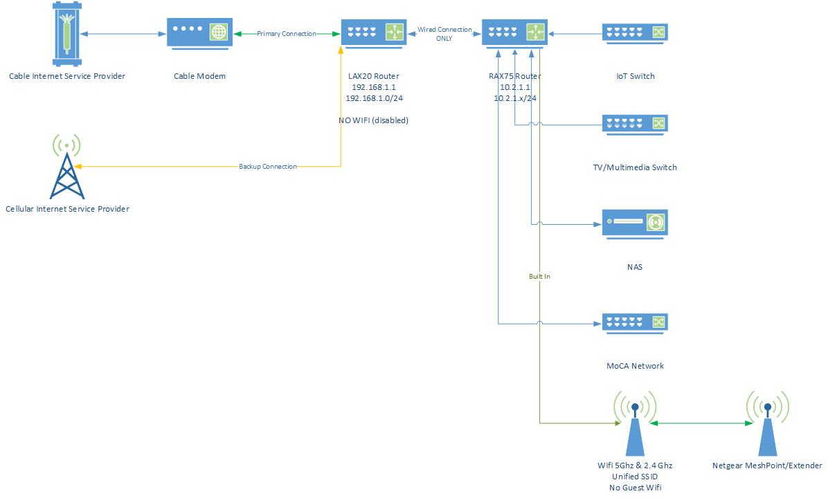

Cable Modem -> LAX20 (Since it can do both Cable Modem Connection & Cell) -> RAX75 -> Rest of network.
Now, I plan on shutting off the WiFi on the LAX20, so I can use it similar to a cradlepoint. I also plan on having this on the 192.168.1.x/24 network. I plan on moving my RAX75 to a 10.2.1.x/24 Network configuration.
My Goal is to be able to have my Cable Internet as a Primary Connection and the Cellular internet as a backup connection, as I have a need to have a constant network connection for work.
In theory, this should work, as I'm creating 1 segment that has extra security (2 Firewalls), and another DMZ-esce higher segment.
Is my thought process correct? If necessary, I can create a Network diagram.

I'd set the RAX75 for AP mode while leaving the LAX20 has you main host router:
https://kb.netgear.com/20927/How-do-I-change-my-NETGEAR-router-to-AP-mode
- LSarfatiTutor
I would prefer NOT to do that, as I want all the WiFi to go through the RAX75 (More Channels). I have a huge network (over 64 devices) and want all communications between the 2 routers to be hardline, not WiFi. I also want to segment off the Core Network (which would be off the RAX75) from the DMZ Network (LAX20). The attached diagram may help to explain.
AP mode would be a hard line between the RAX and LAX router.
