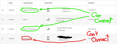

Devices on different bands cannot connect to Google Home
Router - RAX200
I have 1 x 2.4Ghz and 2 x 5Ghz channels, running using Smart Connect.
When the Google Nest connects through 5GHz-1, devices connecting through 5GHz-2 cannot cast Spotify to the hub, share with any devices on 5Gh-1, or see the Google Nest etc.
It's as if devices on different bands are on a different network.
Any way that devices on different bands can see each other on my Wifi? (preferred solution)
Otherwise, is there any way to disable one of the 5Ghz bands without disabling Smart Connect?

I updated the firmware to latest tonight. I can no longer see 5Ghz connections from my router IP or through the android app. When my phone connects over 2.4Ghz I can't cast to the Google Nest, which is connected over 5GHz. After reconnecting the phone a number of times it finally connected at 5Ghz and was able to cast to the Google Nest (Signal strength at 100%, 2m from router, so not sure why it sometimes connects over 2.4). As stated, can't see 5Ghz devices so can't see which band any of them are connecting through.
