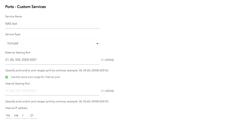

I am not able to foward multiple ports within a service.
For example, if I enter "21, 80, 500, 5000-5001" and apply, only port 21 is forwarded (Pic 1 &2 is what I entered and what actually applied).
My firmware version is V1.0.5.106_2.0.70, is there any solution to fix it? Thanks.

      I found out that I can foward a range of ports (eg. 1-100), but not putting different ports with comma. The problem remains if I go back to modify it. Thanks you help though

  • Try using just single values separated by a comma rather than a combination of single values and ranges in one entry. If it doesn't work then it could be a UI related bug.
  • Any update on this issue?  I'm in the same boat with the RAX50.  My older R7450 works as expected
  • Same issue here. Looks to be a UI bug. Form strings not being parsed correctly.
    Firmware Version V1.0.11.112_2.0.77
