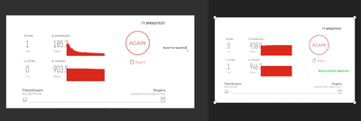

Over the past couple of weeks, I have been experiencing really poor download speeds over Ethernet.
Every single speed test website shows a drastic drop in my download speeds with the exception of Speedtest.net
I can visibly see this poor connection when streaming anything over Disney+
Troubleshooting steps I have tried:
- Confirmed I am on the latest firmware available (Firmware Version V1.0.10.86_2.0.40)
- Ensure QoS is disabled
- Changed the channels for the 5ghz streams (no change)
- Tried different ports in the router and my PC (no change)
For reference I have attached what my speeds look like when connected directly to the wall jack vs. when I am connected to the router. There's a HUGE difference.

Hey Guru, thanks for the quick response.
There is no modem in between the router and the wall-jack which serves as my ISP's source of internet. Again, when connected to the wall-jack, I get the full speed
I have already tried two separate cables i.e. Cat6 and Cat7 with no luck.
I am using a Desktop PC which is connected via Ethernet and am able to reproduce the issue consistently.I have already tried upgrading to another firmware provided by NetGear's team and have also powercycled to no avail.
I have also erased the router and re-onboarded it as per Nighthawk's instructions and again have not seen much difference.- FURRYe38Guru - Experienced User
