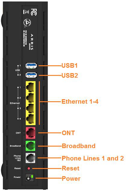

I want to replace my ISP rented router (Arris BGW210-700) with AX50 router. My service is Optic Fiber with an ONT box installed already.
Currently the Arris gateway is connected to ONT via a yellow LAN cable. It has a red port with ONT label which looks exctly like LAN port and reads ONT.
This is ATT multipurpose gateway that supports DSL users as well. I am not using DSL service. So I belive only the router part of the device is active and I should be able to put any router in that place.
Can I connect Netgear AX50 router using the same LAN cable ONT box to "Internet" port of the router? Or do I need another adapter?

And the current ATT gateway is a DSL capable gateway. But as I am using FiOS, the gateway is NOT connected via phone jacks, but with a LAN cable from ONT box to the Internet/WAN/ONT port of the gateway.
I think this means the modem part of the gateway might not be functional.
