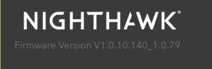

Keeps losing DNS with latest firmware, rolling back to RAX200-V1.0.5.132_1.0.69. Have done a factory reset and still had the issues. Please fix the firmware, for I do like my nighthawk.
