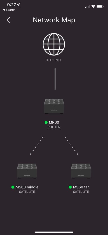

Now, as you can see from the screenshot below, both satellites are connected to the router. The 'MS60 far' satellite is about 30 metres away from the router so I am getting incredibly slow speeds from this satellite.
How do I get the 'MS60 far' satellite to connect to the 'MS60 middle' satellite so that the final signal is stronger?
This is how the system is currently set up which is not good:

  • I am not sure if the screenshot worked in the original post so here it is again:

    30 meters maybe too far between the MR and MS. Might try 10-15 meters and see if anything changes?
    Also how you turn on the MS in sequence may help as well. Turn OFF The MS, Then turn on the first nearest MS to the MR. After that try turning ON the farthest MS.
    If the farthest MS is connecting to the MR, try turning down the power output of the MR from 100% to 50%. Under Advanced Tab/Advanced Settings/Wireless Settings
