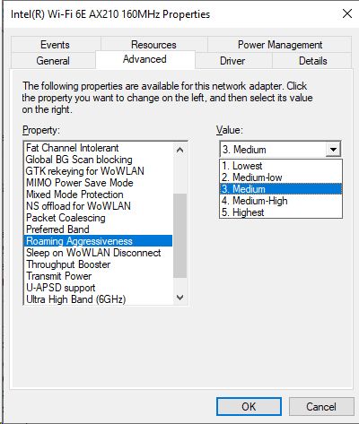

    Client directed roaming varies by device. For smartphones typically unless it is rooted, there is often no control over roaming behavior than what the device maker defaults to.
    On PCs, you will often have some control over how aggressively it will seek out a better AP. PS, the roaming behavior also takes into account your activity. If you are continuously sending data or receiving data, then some devices will stick to an AP for a longer time even if a better AP is closer.
