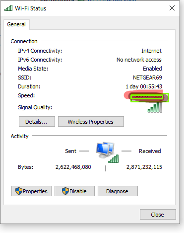

The wifi speed is low all over my house
Cables from home central to ruter = cat6
1. If i use ethernet i get my wantet speed ---> 500/500 mbps
2. If i use 5GHz band,  I am limited to 175mbps, anywhere in my house
If i reset wifi adapter and connect again, still 175mbps
also tried anoher PC, same issue here.
If seems that the router has limited my speed , but i cannot se any options to change this matter
I recon the speed schould be like = 7-800 mbps on my laptop IF I'am near my ruter, but it is stuck @175 mbps.
Is there anyone who has a clue regarding this matter?
