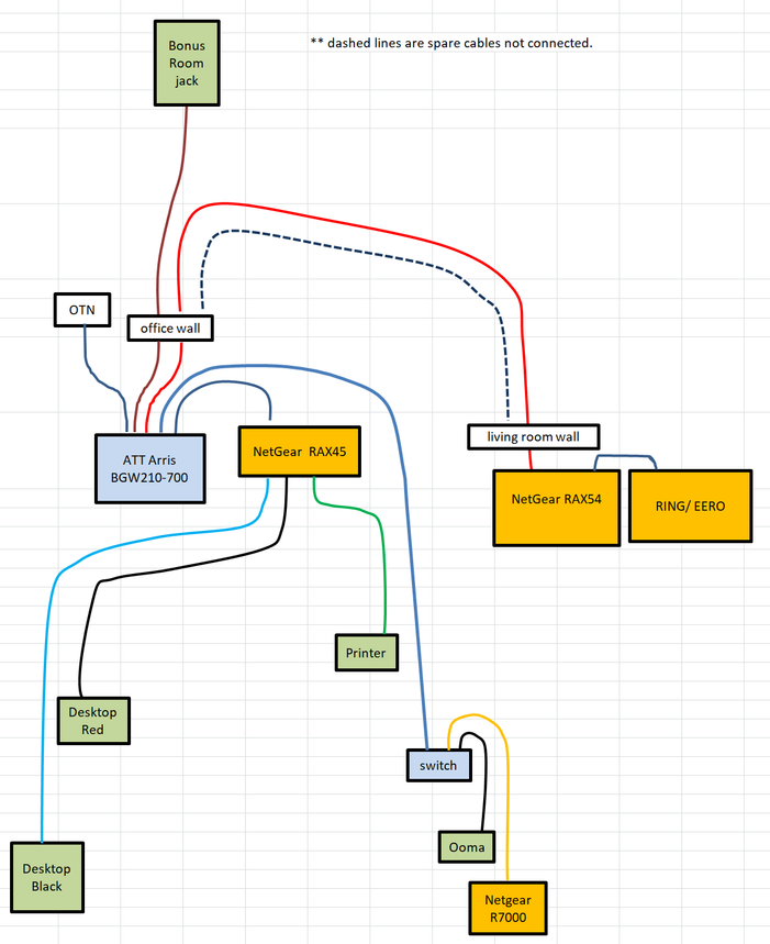

      So, here is a map of my network.  ATT fiber thru OTN, to ATT Arris router.
      From the ATT router, there are ethernet lines to:
                - Netgear router RAX45 (office)
                - 4-port switch, which feeds Netgear router R7000 and Ooma VOIP box.  (The R7000 provides wifi for my 3D printer only).
                - upstairs bonus room, but it is only used if/ when the Netgear wifi goes down.
                - Netgear router RAX 54 (living room)
      RAX45 (office) provides ethernet to Desktop Black, Desktop Red, and a network printer.
      RAX54 (living room) supplies ethernet to a Ring/ Eero router.  Also, all my wifi devices (cameras, smart plugs, thermostats, dehumidifiers, etc) are connected to this router.
      My rationale is to keep the office NG router very pristine, minimal IoT's, and let the living room NG router be the one that carries all the wifi IoT's.
      All routers carry their individual SSID's, all use MAC filtered lists for devices.  SSID's and router access codes are changed from the MFR default codes.
      Other than that, I change very little, since beyond that I know that I don't know what I'm doing.
      This arrangement has worked very well for the past 2-3 years, when I added the RAX54.  Other than adding a camera or smart plug once in a while, nothing has changed.  I did verify the ATT and NG routers do automatic FW updates, and all are showing as UTD.

  • Forgot to mention-  each router has unique SSID/ passwords, credentials, etc.

      20-May-2025 could very well be when this all started.  Will have to debrief my family a little more intensively to see if they remember how far back this began.  I've been digging into the various tabs in both router user interfaces and haven't yet found anything on "lease expiration", but I will keep searching.
      I'll dig around the web management screens to see if I can find anything related to DHCP leases.
      Where do I find the firmware update dates, and previous firmware update files, so I can revert to an earlier firmware?
